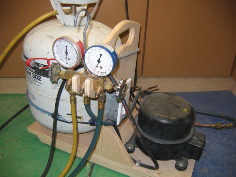

PostPosted: Sun Jun 10, 2007 4:05 pm
Brad,
It is kind of late for you now but I use refridgeration compressors. The ones off household fridges work great for any guitar building and they are SILENT, really, I mean that you really don't know they are running if aren't really really close to them, really!! (I bet you can't use "really" more than that in one sentance ). I use a reservior as well and this system will draw down a brace clamping vacuum jig with no problem at all. I have now collected some larger refridgeration compressors, just because I could get them for free and will make a 'built in' system and keep this one:
for work that is not done handy to the bench. These compressors run continuosly also and I asked my buddy who is a refridgeration guy and he says that once they are under vacuum they are no longer under load so it does not hurt them at all to run like this. AND, if you do hoop the pump, you just go get a couple more...they are free!
Good luck!
